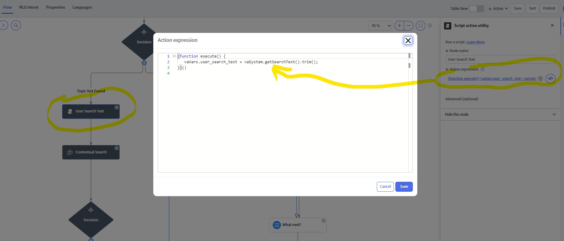

I am exactly facing the same issue while modifying in anything else topic.
I tried in the same way you have mentioned. But, still vaSystem.getSearchText() returns null. I have attached all screenshots for your reference.

After struggling with for so long, I also just found an example in the Search Fallback Topic.  Just look for the "User Search Text" node.  Make sure to add the Script Variable as well.

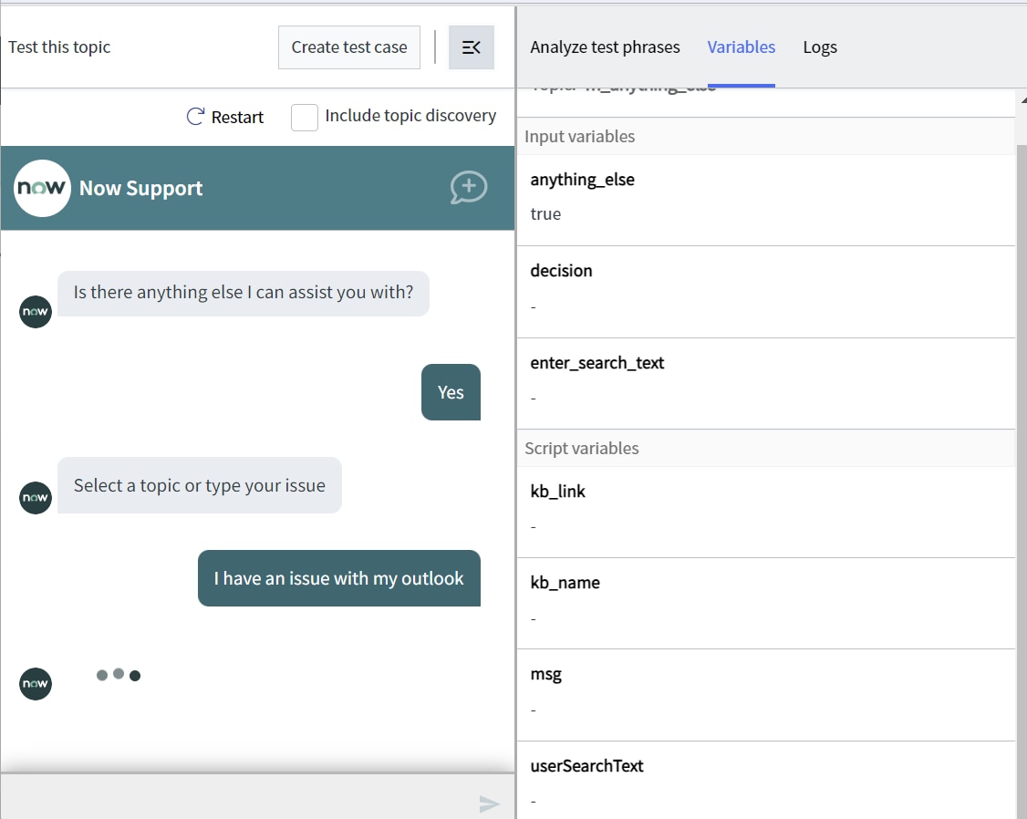

Hi @MB Richards ,
It is not working yet. I have attached the complete recording of what I have done. Could u pls check and revert.
Its better if you record and send the working flow
