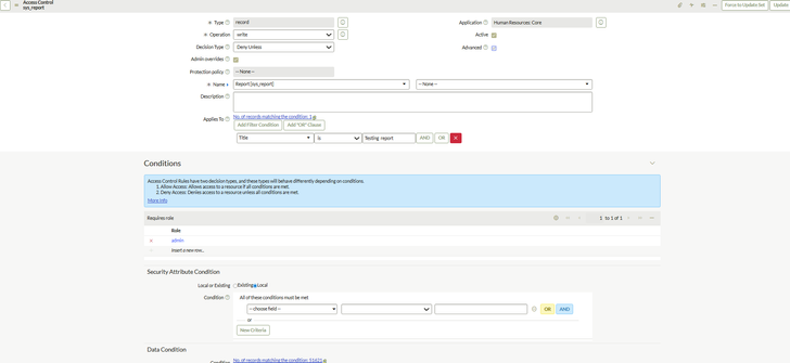

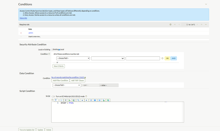

Thanks for the reply @Ankur Bawiskar , I tried but its not working still the end user can edit the filter & run the report , please see the below ACL configuration and let me know if anything is wrong in there, thanks>
@NowNinja727
share screenshot where user is able to edit the report filter condition?
