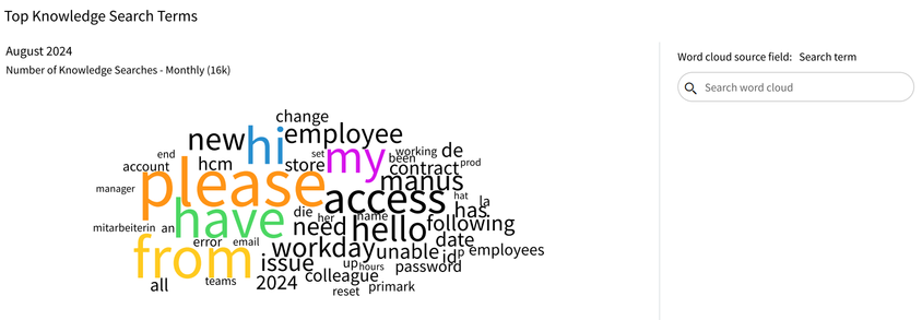

I have a requirement to create a dashboard. The dashboard will be on Knowledge Searches ( ts_query_kb ) table, which captures all the most searched words from Service Portal, tables, short description, everywhere, along with the repeat count. Screenshot below.
So, in the search bar below, if you type any word, it will show the word along with how many times, it got repeated... Meaning, the word will come on dashboard and when we hover on the dashboard, it will show more details. The data shown should be monthly wise. You can see below (16k searches made it Aug 2024)

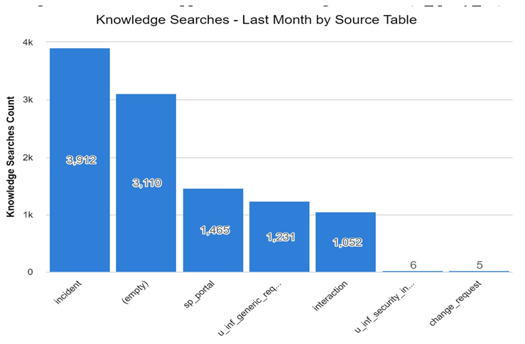

Below is how the report  data will have on different tables,.... just as an example/reference... please neglect. I just want the above dashboard.

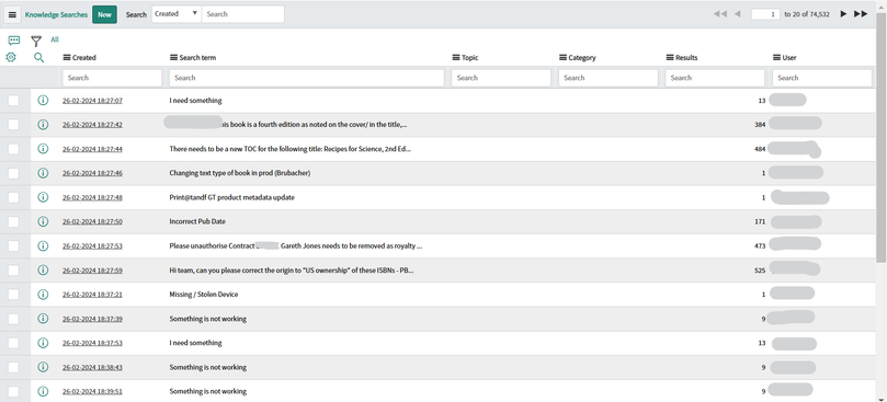

This is how Knowledge Searches table will capture all the most searched-words.
2 ACCEPTED SOLUTIONS
Dr Atul - LNG
Hi @AbdurRahmanSnow
https://www.servicenow.com/community/platform-analytics-forum/step-by-step-word-cloud/m-p/1214894
https://www.youtube.com/watch?v=5TH-0w0KF_U
Guest Star, Harshini Elath, demonstrates how to setup and use Spotlight and Word Cloud Performance Analytics features in Kingston.
AbdurRahmanSnow
Thanks a lot Sir. Really appreciate. The above video will help me out.
I too, got one more video related to this.
https://youtu.be/keTKXi6N0Os?si=WWY5zdU8bTOM2Ae4
Learn how to create a Performance Analytics text analytics word cloud widget, which analyzes unstructured or qualitative data. You will also learn how to set up and collect data for text analytics widgets. Applies to ServiceNow releases starting with Kingston Role required: * pa_power_user or ...
