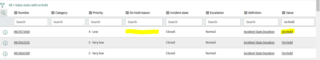

I received a requirement to create a report to show incidents where incident had/have state on hold with on hold reason.
I created a report on incident_metric table but issue is on hold reason is showing empty for closed incidents. Is there any way to get on hold reason for closed incidents that were in on hold and later closed.

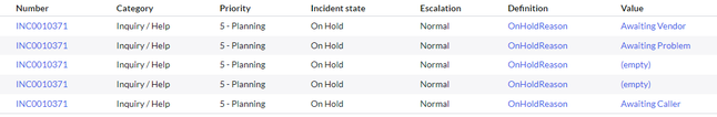

Hi @sushmitha2 ,
You need to create a metric definition which is based on the "on hold reason" instead of the state. By doing this, you will capture the on hold reason and not "just" that the state was on hold:

Hi @sushmitha2
Go to:
Create the metric definition as shown below:
Next, go to
And press:
Create your report based on the incident_metric table:
With below condition:
Which will give you as example report below:
