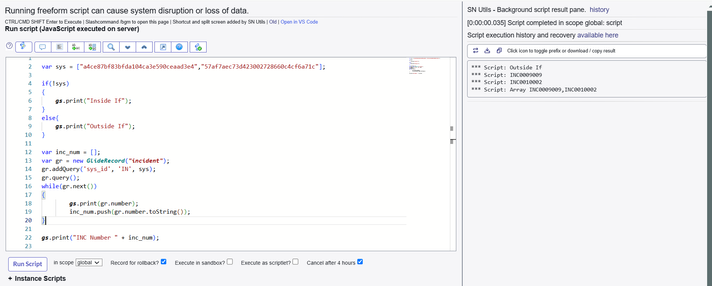

For debugging use:
1. gs.info (server Side) to check if glidesit array is storing proper values. If yes, then check values are correctly pushing in your result array again by gs.info()
2. g_form.addInfomessage(response) (Client Side) to check what is your response showing or try to write your code in Background Script for quick testing to check script include code.
Please refer the snip on similar lines and make changes accordingly.
