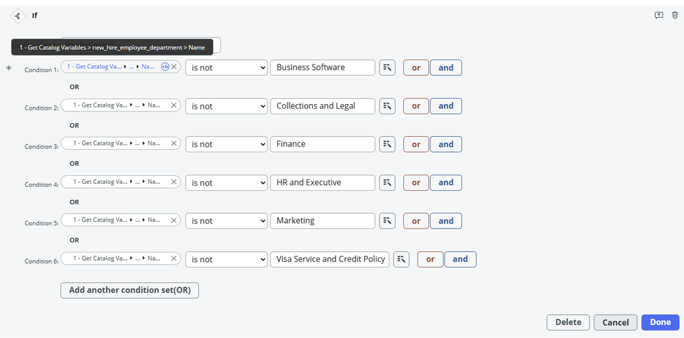

I am receiving an error on an If condition. I tried all that I could think to resolve.
This variable is a reference of business_unit. I tried this as just the string and as a dotwalk (as seen below).
I verified that Business Software is in fact a valid Business Unit.
{0}!=Business Software is not a valid conditional expression
Encountered error executing instruction: EvaluateConditionalInstruction{id=196, valueTemplate=ValueTemplate{usageType=string, parts=[Ref{refKey=c1o.new_hire_employee_department, dotWalk=name, type=string}, StringStaticValue{value=!=Business Software ^NQ, isPill=false, type=string}, Ref{refKey=c1o.new_hire_employee_department, dotWalk=name, type=string}, StringStaticValue{value=!=Collections and Legal ^NQ, isPill=false, type=string}, Ref{refKey=c1o.new_hire_employee_department, dotWalk=name, type=string}, StringStaticValue{value=!=Finance ^NQ, isPill=false, type=string}, Ref{refKey=c1o.new_hire_employee_department, dotWalk=name, type=string}, StringStaticValue{value=!=HR and Executive ^NQ, isPill=false, type=string}, Ref{refKey=c1o.new_hire_employee_department, dotWalk=name, type=string}, StringStaticValue{value=!=Marketing ^NQ, isPill=false, type=string}, Ref{refKey=c1o.new_hire_employee_department, dotWalk=name, type=string}, StringStaticValue{value=!=Visa Service and Credit Policy , isPill=false, type=string}], isJsonEncodingRequired=false}, outputKey=c30.if_cond, ifSourceAlias=c30}
com.snc.process_flow.model.InvalidProcessException: {0}!=Business Software is not a valid conditional expression

What's the deal?
Thank you
Scott A
06-18-2026 12:52 PM
I discovered the issue was a very rookie mistake.
Copying from a formatted Excel was causing issues.
You the format and random end spaces were removed, it was able to create.
