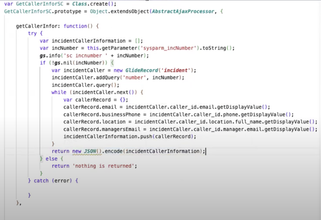

Hi @Vidya Shree ,
Sharing a sample code that I have created, where I drilled down the object from a parent to a child key-value pair until I got the value. Using multiple JavaScript techniques with a combination of ServiceNow objects.
Btw, this is not production code, I created it for a demo purpose to fetch and display the values from the server to the client side.
You can watch the details from 36:28 to 48:40
Here is Where: Scripting in ServiceNow Fundamentals
