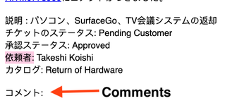

when notification is getting triggered, then content i.e. Additional comment is not coming, only work notes is coming. What should be checked?
Notification which user received:
Notification (what it will contain):

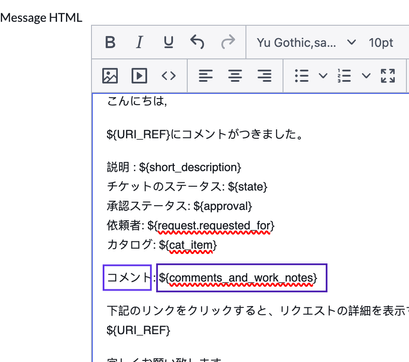

One question team,
We should not use: ${comments_and_work_notes} ??????
as using ${comments_and_work_notes} the comments should get attached to the email but it is not getting attached to the??? why so

08-19-2024 08:19 PM - edited 08-19-2024 08:19 PM
Solution provided by ServiceNow team:
As work notes and additional comments at a time, in email properties you have mentioned to append on 1 journal entry, that is it is taking only lated journal entry i.e work notes and not appending comments in notification
Solution Proposed:
-- So if there two journal entries at a time, if you want include two entries in notification you can update "Number of journal entries" in email properties.
Email properties
