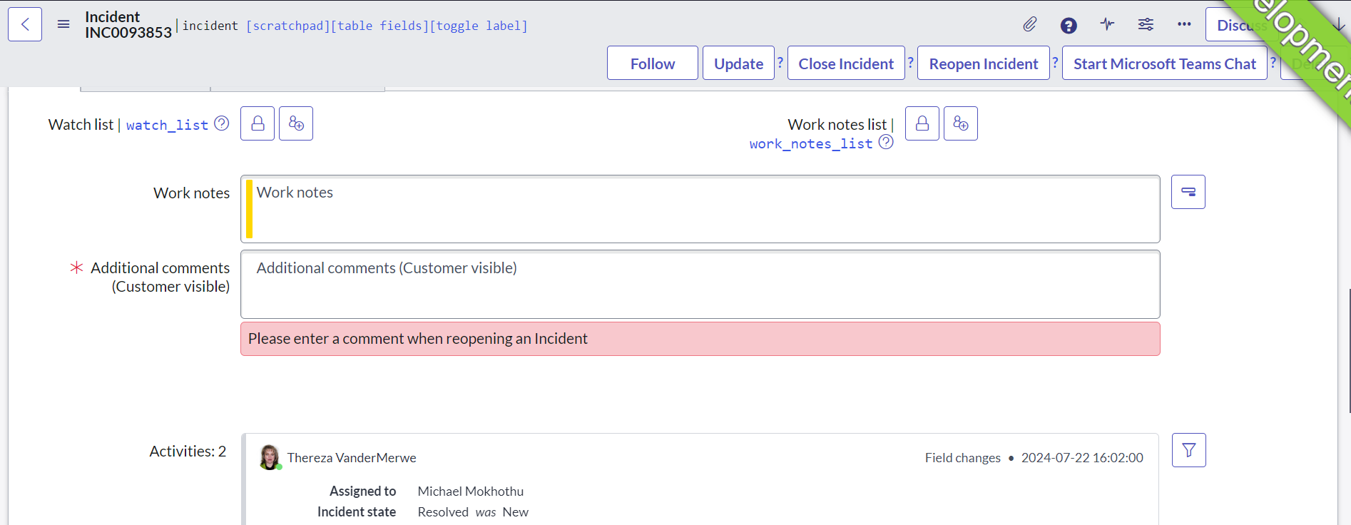

Thereza Van der
Hi Swathi
Screenshots attached. It still jumps to additional comments when clicking on reopen incident.
