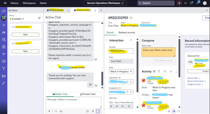

We tried using REST API Explorer and tried POST message and chat conversation is being initiated. (Screenshot below).

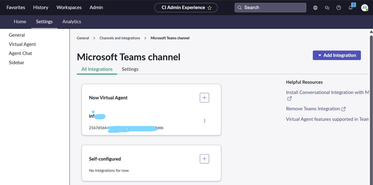

I checked in Conversational interfaces>Settings, I found an integration connector setup as below, but the same is not setup in Dev instance.
Also, the below ID is same on Production and Test instance.
Should I remove this ID? May be, because of this chat is not coming from Teams -> SOW.

‎09-28-2025 08:10 AM
@AbdurRahmanSnow I have seen a similar issue in past, You have integrated SN dev with Teams dev instance? and now you are trying to integrate SN testing instance with same Teams dev instance? What I have seen is that you cannot integration 2 SN instance with same teams dev instance.
What you can try is removing the dev integration and setting up with testing instance.
Please mark the answer correct/helpful accordingly.
