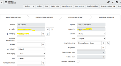

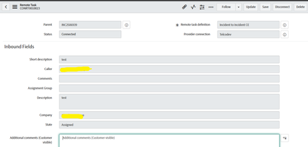

I made the changes and used same script logic but still the same, the Assignment group in the provider instance, showing as undefined in the connected remote task.
Consumer instance ticket created
The provider received incident
Also i observed, the provider transform is getting executed and showing the first log (the group name from input.label). But after doing glide query with the same group name to get sys id, that logic is not being executed. because,
In the provider instance on the incident i can see in show xml it was showing the consumer group sys id but not the target provider instance group sys id, also the second log which i have added after querying that is not executed.
