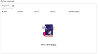

After the Australia release, we have been experiencing an issue when accessing reports that were created prior to the release.
Although I have all the required roles and permissions to access these reports, I am still unable to view them. When I open the reports, the message "No records to show" is displayed. Please refer to the attached screenshot for reference.
Could someone please assist in investigating this issue?

Hi @UmamaheshC32034
From the screenshot shared you have access to the report but there is no data available. Try edit the report and look at the data source - this could be the issue.

Hi @UmamaheshC32034
Reports no longer public
On upgrade to Australia, all public Core UI reports are unpublished to enhance security awareness and control. The glide.report.published_reports.enabled property on all Core UI reports is set to false. Users with the report_admin role can navigate to the sys_report_public table to view unpublished reports and enable the public capacity or enable sharing with logged in users inside the platform. For more information, see (Legacy) Publish a report.
