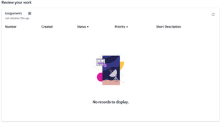

After the Australia release, we have been experiencing an issue when accessing reports that were created prior to the release.
Although I have all the required roles and permissions to access these reports, I am still unable to view them. When I open the reports, the message "No records to show" is displayed. Please refer to the attached screenshot for reference.
Could someone please assist in investigating this issue?

From the screenshot shared you have access to the report but there is no data available. Try edit the report and look at the data source - this could be the issue.

Reports no longer public
On upgrade to Australia, all public Core UI reports are unpublished to enhance security awareness and control. The glide.report.published_reports.enabled property on all Core UI reports is set to false. Users with the report_admin role can navigate to the sys_report_public table to view unpublished reports and enable the public capacity or enable sharing with logged in users inside the platform. For more information, see (Legacy) Publish a report.
