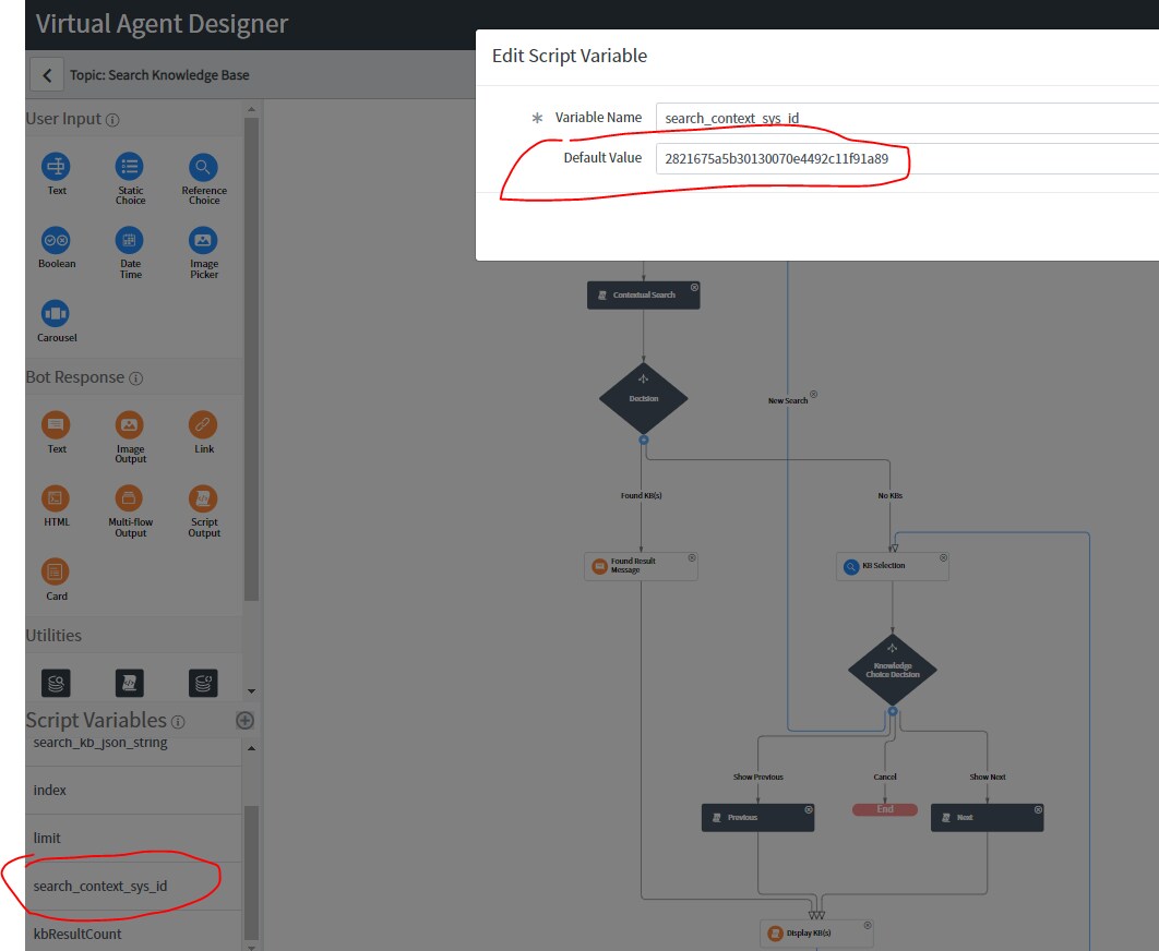

Are you already experiencing this with the out-of-the-box Search Knowledge Base topic? Or custom topic?
Did you check if there is a Contextual Search setup? For example, out-of-the-box:
Contextual Search > Search Contexts > ITSM VA Knowledge Search
The sys_id of the record shown above, also corresponds with what is setup in the Search Knowledge base topic:

As Mark indicates, in order to create a KB search through the virtual agent, we consume the contextual search API. In the prebuilt topics, you will find the sysID of a search context passed as a script variable or within a script utility itself. This sysID should be from a search context record which the instance should already contain. Search contexts can search a variety of kb, kb+catalog, etc.
