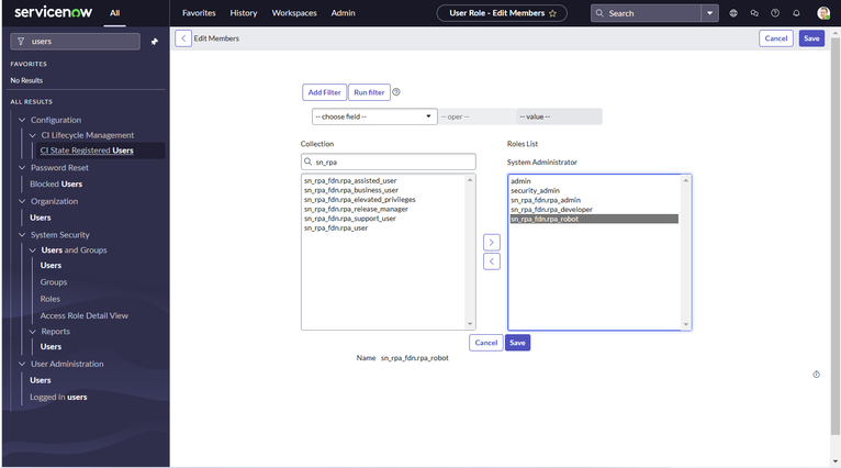

  • My SN user didn't have the correct roles (actually I was lazy and did it all under my admin login but this was still the case). While you are there add the robot permission - see later for error if this is omitted.
Access is Denied when publishing an automation in RPA Desktop Design Studio - Support and Troublesho...

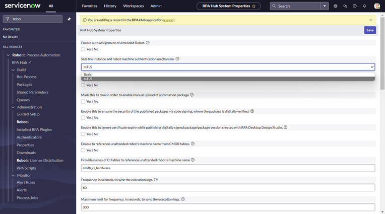

  • Basic authentication not supported:
Connecting Unattended Robots to RPA Hub - issue 1 - basic auth not supported.png

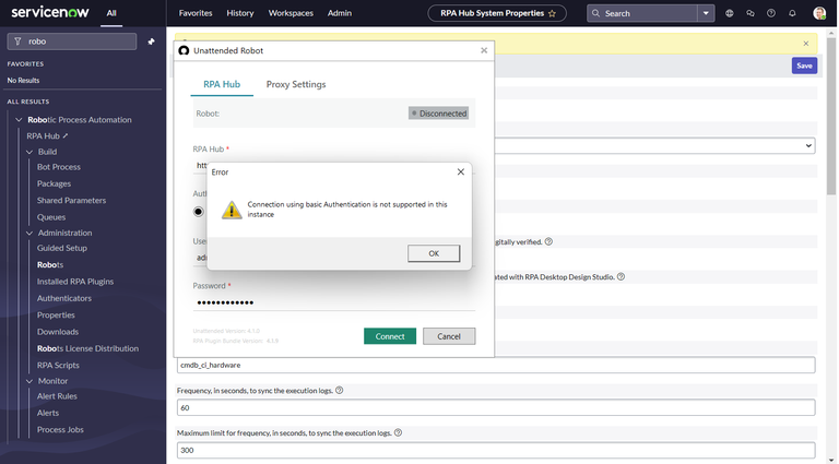

  • No access to connect robot
Connecting Unattended Robots to RPA Hub - issue 2 - no access to connect robot.png

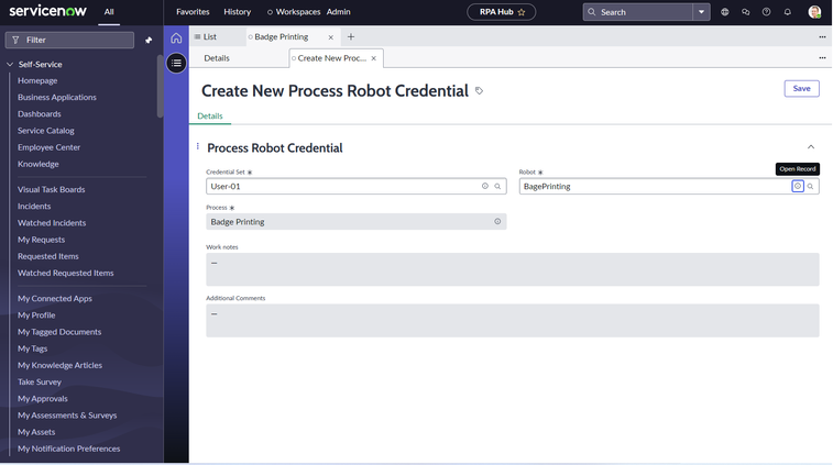

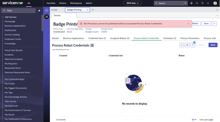

  • Missing credentials when publishing the bot

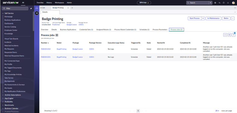

  • And finally, for fun, that moment when you realise you are both lazy and an idiot:
I actually have HyperV on this machine but noooo, let's just do it here with my creds...  I'm going to log out now and stare at a login screen for 2mins. 🙃
