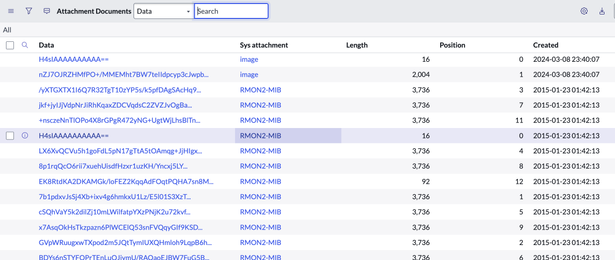

I am not sure about it and I need to check whether it works or not however even if I want to glide the particular records multiple requestors might attach same file then how should I glide correct record to get the data field value?
ex.  you can see below multiple records are having same file name.
