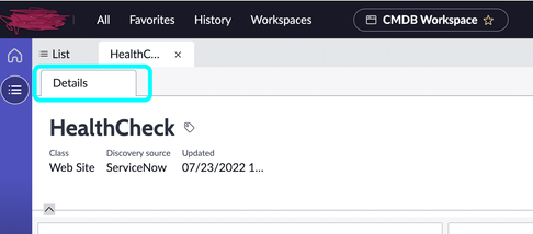

Hello Guys,
I am learning UI Builder And Want to learn how we Rename "Details" tab open a Ui Builder form,It Seems ,Its OOTB.

Hello Yash,
Did you figure out how to rename the "Details" tab name?  Our customer asked for the same changes and we haven't been able to figure out.

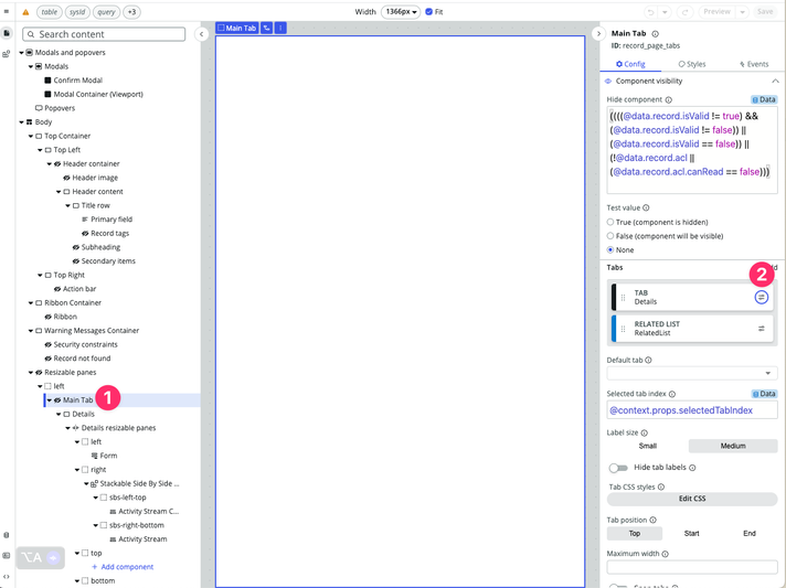

If you are using a Configurable workspace... you should be able to go into the Record page in UIB, find the Tab component (mine is called "Main Tab" yours may vary...) and click on it to expose the Config settings for the component. From there you can Edit the name.
Hello Paige,
Thank you for responding to me.  I tried your suggestion.  It didn't change the "Details" label for the tab that I tried to do.  Do you know how to change the tab above the "Customer Information"?  Thank you again for your help.
