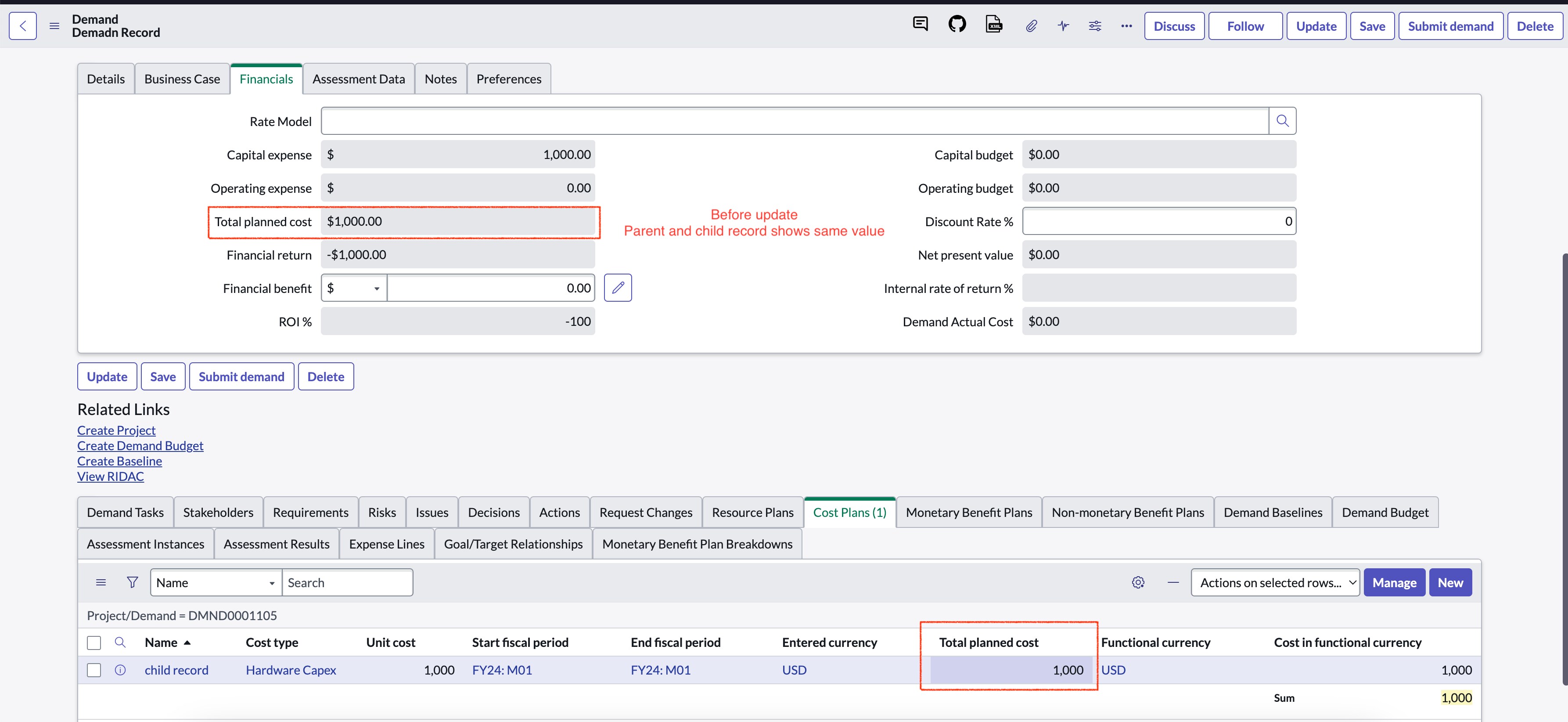

When a user updates a child record (such as a resource plan or cost plan that rolls up the total planned cost on the demand record) from the related list and immediately clicks the save button for the demand form, the values from the child record get updated to the demand record and are later overridden with the previous value.
For example, if the demand shows a total planned cost of $1000 and the user updates the child record (cost plan) to make the total planned cost $1500, the history of the demand record will show the value changing from $1000 to $1500 and then back to $1000.

Business rules on cost plan are correctly set, it is updating the planned cost correctly on demand record. This issue comes only when user click on save action of demand record immediately after updating child record (cost plan).
Audit history also shows this updates. Attached the screenshots.
On save of Demand record, we are doing current.update(). I am suspecting it is reverting the value, but not sure why only few values are getting overridden not all.
