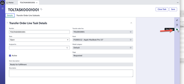

I'm looking to use the Document Display component to show our users a document while they are working on a related record.  I would like it to stay in the sidebar, similar to the attachment list or templates.  But no matter where I've tried to use Document Display it uses the entire tab, and you can't see the related content.

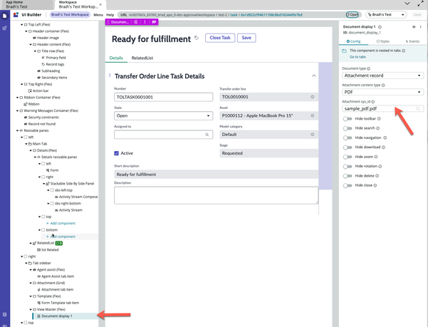

Here you see add the component document display and set an attachment for reference.
The side bar shows

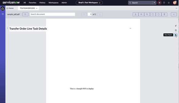

Then when you click on it this happens

Hello @bradwestvig, @tstocking and @stephenfarr, I managed to solve this by creating a container (Layouts -> Flexbox) with the following CSS settings for the internal layer:
    display: flex;
    flex-direction: column;
    height: 1500px;
    position: relative;
    width: 100%;
The key here is the position: relative; property. You can adjust the other settings based on your needs and requirements. Inside this container, insert the Document Viewer component, and it will stay within the container. Hope this helps others who may encounter the same issue.
