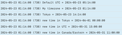

Here are the results:
getValue() will always retrieve the date/time in the UTC timezone.  getDisplayValue() will get it in the current timezone of the GDT object.  Same thing with setDisplayValue(), it uses the current timezone of the GDT object, which by default is the current users timezone.  You override it by using setTZ().
