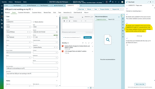

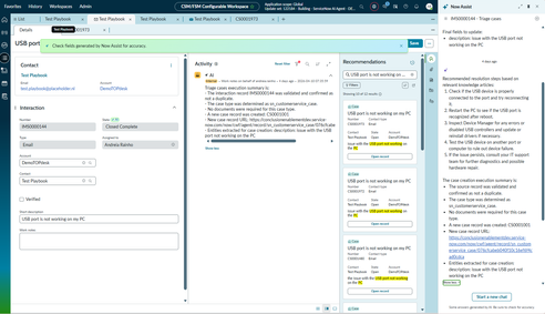

  • I created an interaction where the workflow runs and a case is created by the AI Agent, as shown in the attachment “Triage Cases - Interaction that created a Case.”
  • However, after the case is created, I can see that the Agentic Workflow “Triage Cases” was executed, but no additional information is provided, as shown in the attachment “Triage Cases - Case Created From Interaction.”
After reviewing the available documentation and the workflow description, I am not entirely certain whether this workflow is expected to function when a case is created directly. However, since the case meets the trigger conditions, I would expect the Agentic Workflow to process it and provide additional information.
Could you please provide more information on how this workflow is intended to work, particularly when triggered by a case? Additionally, is this behavior expected, or is there any additional configuration required?

Hard to say, but you might be running into a bug, depending on which version of the application you're on. In the Triage Cases Agentic Workflow, there's a Context Validator AI agent, which runs the "Get record details" tool. The tool has this script:
(function(inputs) {
    var output = {};
    var CSMAIA = new sn_csm_ai_agents.NowAssistCSMAIAgents();
    output.source_record = CSMAIA.getRecordDetails(inputs.record_table, inputs.record_sys_id_or_number);
    if (gs.nil(output.source_record))
        return "No details were available for the source record.";
    return output;
})(inputs);
It appears that the tool (and script) is failing to acquire the Case record correctly from its given inputs. You may want to open a Support case on Now Support for further investigation as this artifact has read-protection.
