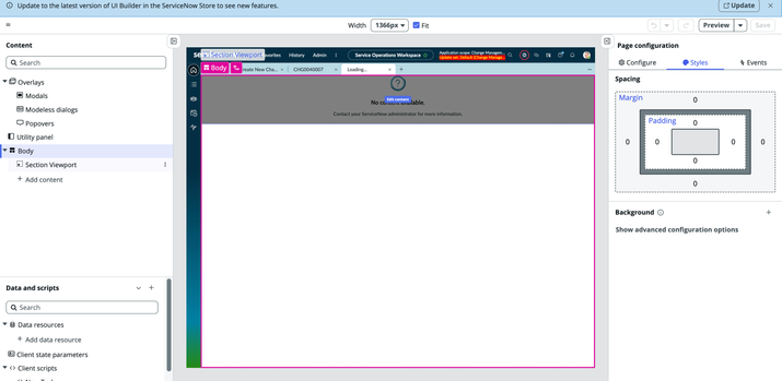

- Go to Now Experience Framework → UI Builder from your application navigator.

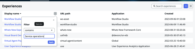

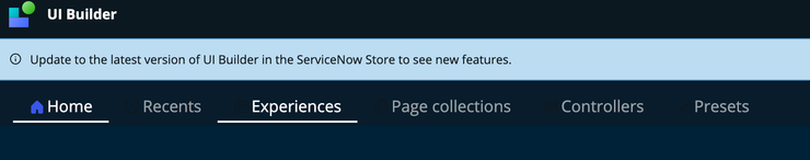

- In the UI Builder home page, open the Experiences tab.
- Search for Service Operations Workspace.
- Open the Service Operations Workspace experience.

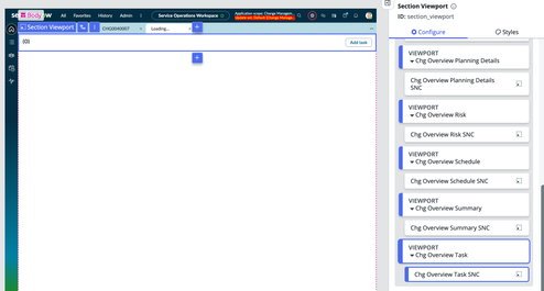

Inside the experience, search for and open Chg Overview Viewport SNC.
- In the left panel, click on Section Viewport.
On the right-hand side (bottom panel), double-click Change Overview Task SNC.
Tip: You can also confirm in the preview pane that the Add Task button is visible under the Overview tab.

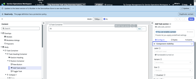

🧰 Step 6: Configure the Add Task Button
In the left panel, locate the Add Task button section (under the Button Container).
Click on it and open its configuration in the right panel. Navigate to the Configure tab.
⚙️ Step 7: Disable or Hide the Add Task Button
You now have two options:
Option 1: Disable the Button
check the Disabled toggle under Configure.
This will make the button visible but unclickable.

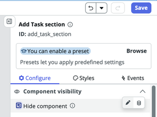

Option 2: Hide the Button
In the same Configure tab, expand the Component Visibility section.
Click on the pencil icon beside Hide Component.
Check the Hide Component checkbox.
Save your changes. This approach ensures the Add Task button is completely hidden from view in the Change Overview tab of the Service Operations Workspace.

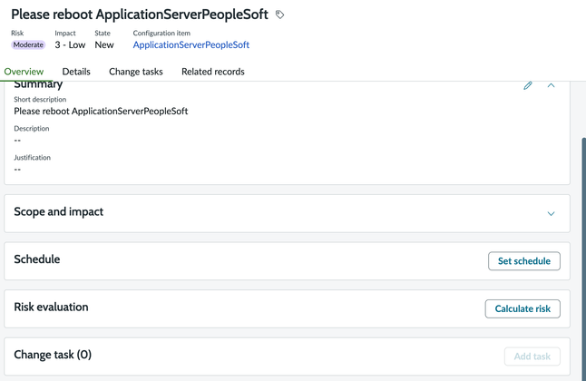

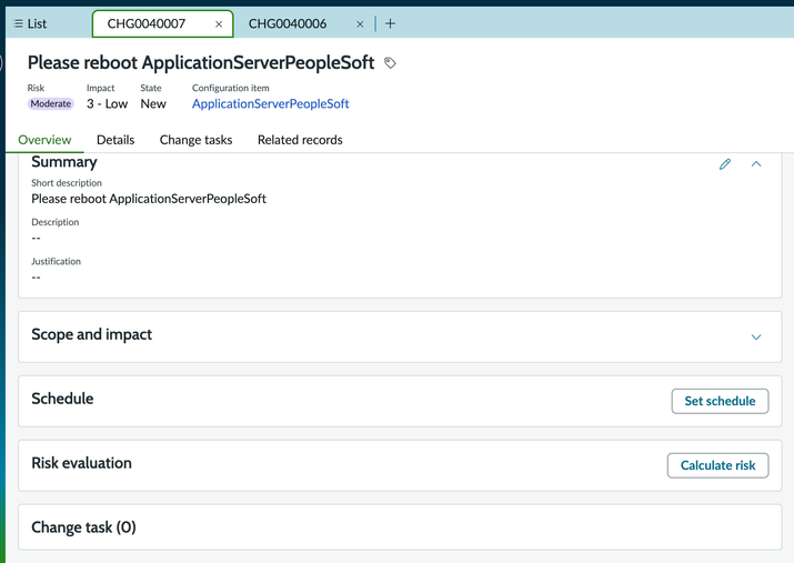

Final Outcome
Once saved, open the Service Operations Workspace → Change Form → Overview Tab to verify the Add Task button is no longer accessible or visible — depending on your chosen configuration.
