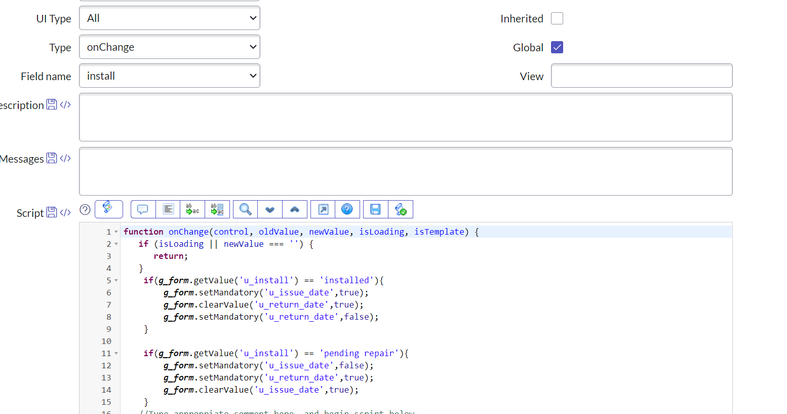

I have a requirement in cmdb form , we have fields inn CMDB computer form
based on the install status
when install status is installed ,issued date is mandatory and clear the returned date
when the install status is pending repair or in stock issued date is empty and Return date will be mandatory
How to achieve thsi

I THINK NEED CLIENT SCRIPT
07-26-2023 09:57 AM
Please find the solution
If its correct please mark the answer as correct
return;
if(g_form.getValue('u_install') == 'installed'){
g_form.setMandatory('u_issue_date',true);
g_form.clearValue('u_return_date',true);
g_form.setMandatory('u_return_date',false);
if(g_form.getValue('u_install') == 'pending repair'){
g_form.setMandatory('u_issue_date',false);
g_form.setMandatory('u_return_date',true);
g_form.clearValue('u_issue_date',true);
Thanks in Advance
07-26-2023 10:35 AM
Not working
