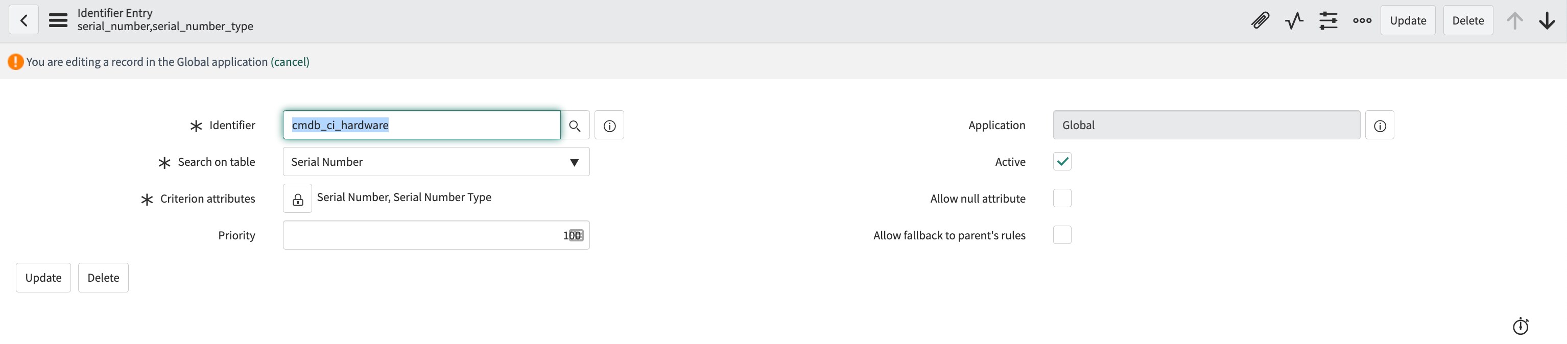

The best way to view IRE rules is through the class manager. If we walk through the identification rules for hardware you can see that the first rule is a lookup on serial number. Clicking into this rule shows the Serial Number table as the Search On Table for this lookup.
Likewise on the form the Search on Table is shown as Serial Number:
