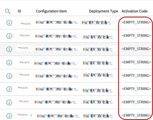

Hi
We are also facing the same issue, we did try the implementation approach for the San Deigo that you provided, but when we try to do the same in Quebec and Rome, we are getting "<EMPTY_STRING>" as a value instead of empty.
As you can see in the below image, for Quebec we are getting "<EMPTY_STRING>" instead of actually getting empty.
do you know any alternative approach for the same which can work on all the Quebec, Rome, and San Deigo versions of ServiceNow?
‎07-20-2022 01:23 PM - edited ‎02-27-2023 09:16 AM
As mentioned in the solution, this feature is only supported starting from San Deigo, so it is expected that it's not working in Quebec or Rome release.
For Quebec and Rome release, IRE does not support updating records to empty values. Users need to use methods other than IRE+IH-ETL. Alternative could be custom scripts updating.
