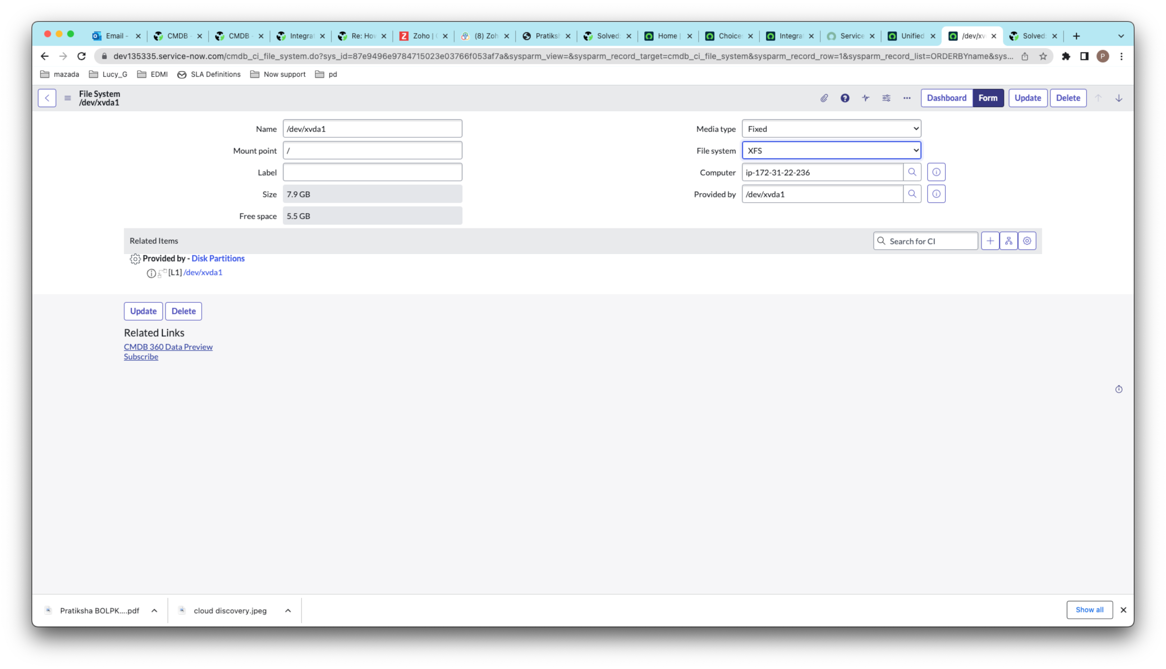

Or you can simply do this like this. loading data in file system table. And the input data is same as the choice value. It will directly work
