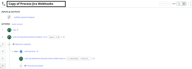

Did you done necessary configuration on the subflow(ootb comes with jira plugin) i.e "Copy of Process Jira Webhooks" :

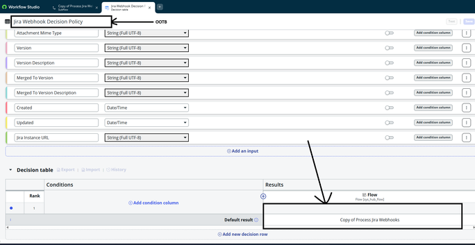

Also adding that subflow into decision table which is also Ootb :
If you had done already, plz check the executions is the payload triggering or any error coming..
