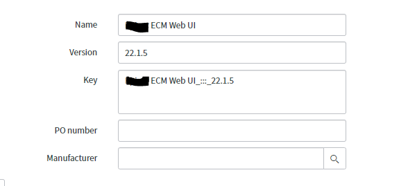

It could help the community here if you post examples of the duplicates you are seeing.  I would recommend that you don't change the OOTB IRE rules.  The key field on the cmdb_ci_spkg table follows a very specific format and is set by the Update key field business rule.  Within this business rule you can see the format that is expected.
Without any further detail my guess would be that the Qualys CMDB Sync application doesn't properly follow the format for the key field on cmdb_ci_spkg.  If it doesn't, the business rule will kick in and modify the value, then a duplicate will come in because the values out of Qualys's application do not follow said format and the business rule has changed what Qualys sent.  If that is the case I would ask Qualys to fix this within their application as any changes to IRE rules or business rules will cause issues as other integrations will likely expect those to be OOTB.

I put the images here as examples of what is duplicated. As you can see, the Ci's have the same name but a different version. I'm not sure how the CMDB works but I was as expecting to update the CI's instead of creating a new one. According to what you explained to me, the BR "Update key field" would be adding the values to these CI's if they met the conditions. I momentarily disabled the BR to prove this point, but even so the CI's were created with the format that you can see in the images which means that Qualys sends the data that way. What could it be then? Thanks for the help.
