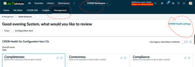

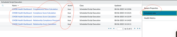

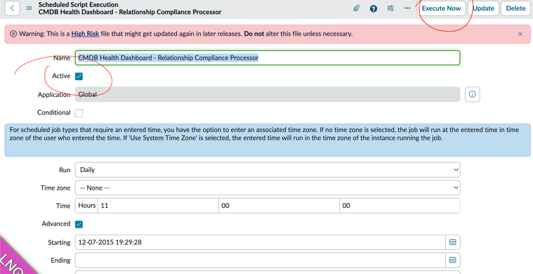

Hi @siddheshagn
  • Go to CMDB Workspace.
  • Open the Management tab.
  • On the top left, click CMDB Health Settings.
  • A new page will open.
  • In the second tab (Scheduled Jobs), open the required job.
  • Click Execute Now.

Go to Health Dashboard > CMDB Health Settings Button(On Top Right) > Scheduled Jobs
Check CMDB Health Dashboard - Relationship Compliance Processor and CMDB Health Dashboard - Relationship Score Calculation.
Click on Execute Now button before activating the schedule.
