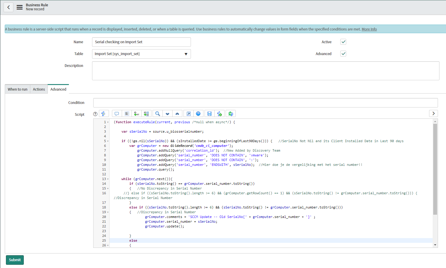

Thanks, I like your second idea the most when this is less difficult to apply I think. For this second idea, should you create one business rule:
1- with the appropriate filters on the tab 'When to run' (see screenshot 1)?
2 - with a script on the tab 'Advanced' (see screenshot 2)?
Script:
	var sSerialNo = source.u_biosserialnumber;
	if ((!gs.nil(sSerialNo)) && (sInstalledDate >= gs.beginningOfLast90Days())) { 	//SerialNo Not Nil and its Client Installed Date in Last 90 days
		var grComputer = new GlideRecord('cmdb_ci_computer');
			grComputer.addNullQuery('correlation_id'); 	//New Added by Discovery Team
			grComputer.addQuery('serial_number', 'DOES NOT CONTAIN', 'vmware');
			grComputer.addQuery('serial_number', 'DOES NOT CONTAIN', ':');
			grComputer.addQuery('serial_number', 'ENDSWITH', sSerialNo);  //Hier doe je de vergelijking met het serial number!!
			grComputer.query();
	while (grComputer.next()){
		if (sSerialNo.toString() == grComputer.serial_number.toString())
		{	//No Discrepancy in Serial Number
     //} else if ((sSerialNo.toString().length >= 6) && (grComputer.getRowCount() == 1) && (sSerialNo.toString() != grComputer.serial_number.toString())) {	     //Discrepancy in Serial Number
		else if ((sSerialNo.toString().length >= 6) && (sSerialNo.toString() != grComputer.serial_number.toString()))
				grComputer.comments = 'SCCM Update -- Old SerialNo[' + grComputer.serial_number + ']' ;
				grComputer.serial_number = sSerialNo;
				grComputer.update();
		else
			gs.info('No discripency found');
ignore = true;
})(current, previous);
