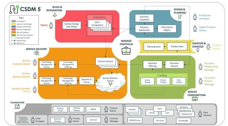

The CSDM Schema
What you see here is a sophisticated and - hopefully - intuitive attempt to show what a "healthy organization" should look like with all its organs and their interconnections. Now, an organization is a species; and this means that not all organizations would reveal the same image as above. But it is my understanding that, this is where "the evolution" (if you follow the metaphor still) shall lead to – indeed, the survival of the fittest.
So, the ultimate purpose of CSDM, correct me if I am wrong, is to create a "perfect whole" out of your otherwise seemingly disparate yet somehow interconnected businesses. There is an important and deeply philosophical issue at play here. Let me explain this.
