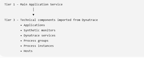

I’m looking for some advice on the best way to model application sub-components in ServiceNow ITOM.
We currently ingest application and infrastructure data from Dynatrace into ServiceNow using the Service Graph Connector.
Our current service structure is:
The current gap is that there is no logical layer between the main application service and the detailed technical components.
For example, one main application may contain business or functional areas such as:
Dynatrace can identify and monitor technical entities such as services, process groups, process instances and hosts. However, it does not know which of these technical entities belong to a particular business sub-component. This information would need to come from the application owners.

07-31-2026 06:36 AM
Hi @wijayantha8
The advice from ServiceNow is not to create parent/child service records, but to create them all at a single level.
What slightly confuses me is how you got to tiered services from application sub-components? To what do business/technical consumers request access? It seems unlikely you would create Service Offerings for each application sub-component, unless they genuinely offer a specific level of service to specific stakeholders.
To me you need to model how the applications relate to one another - e.g. create a Platform Host Business App called Dynatrace, then Platform Application Business Apps for the sub components. You would then have one App Service per Business App, and have them all depend upon the Platform Host Business App.
This takes care of the underlying infra. What then connects to the Service Offering(s) you choose to create depends upon your own internal analysis. If each sub-component really needs to be its own Service Offering then you have a 1:1 Service Offering to App Service; however it's more likely that you need better-defined Service Offerings that offer a genuine outcome to a technology consumer, which may be provided by one or more sub-components.
How you bring this data into ServiceNow is up to you - but I believe The Dynatrace Service Graph Connector already creates Calculated Application Services for you (or it did the last time I looked at it).
The general idea with CSDM is to try to map out what actually happens in the real world, as far as you can.
I hope this helps!
