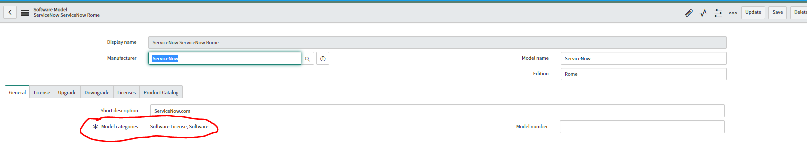

We need to be able to use CSDM to map which technologies/versions/model is linked to an application service, and as said above you are not able to add model categories to a software model, as this field is read only.

And the software model - you are not able to add other model categories 😞
Not sure if below makes any sense, but @Eric Dohr , @scott.lemm @Mark Bodman  please explain how ServiceNow intend to support linking models to Business Application/Application Service without APM? as below, thanks
