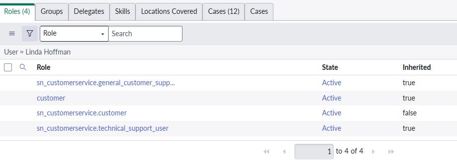

When customers try to add an attachment to a Case record from the Service Portal, the attachment is not getting uploaded or saved. This issue occurs only for customer users on the portal.

Ankur Bawiskar
@Saranya M2
seems to be ACL issue
Did you debug using Access analyzer?
that customer is able to add comments etc to case?
Is that case closed or open?

hi @Saranya M2 ,
Can the user create an entry in the sys_attachmenttables . please using the "debug security rule"can you check acl . this might be  because of missing ACL (Access Control List) or cross-scope access permissions.

SumanthDosapati
@Saranya M2
In ServiceNow, the glide.attachment.role system property controls which user roles can create attachments.
Please check if this is the issue.

Its_Sagnic
Giga Guru
Hi @Saranya M2 ,
Basically your problem may occoured from an ACL.
To resolve this, focus on Access Control Lists (ACLs) and User Criteria, as this is a permissions issue specific to external roles (e.g., snc_external).
1. Check sys_attachment ACLs :
The most common cause is the user lacking permission to create records on the attachment table.
  • Fix: Ensure there is a Create ACL for sys_attachment that grants access to the snc_external or sn_customerservice.customer role.
2. Check Table-Level Write ACLs:
Users cannot attach files if they cannot "write" to the record itself.
  • Fix: Verify the user has Write access to the Case [sn_customerservice_case] table. If the Case is in a "Closed" or "Resolved" state, ACLs often block updates; you may need to adjust these to allow attachments on closed records.
