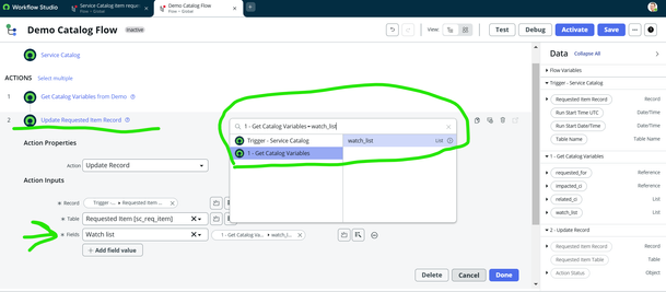

If you creating SC Task using Flow Designer then you can do following to map RITM Field with the Catalog Variable (Both should be of same Type of Field/Variable):
  1. Update RITM record using Update Record Action.
  2. Select your RITM Field "Educational unit Impacted" and map it with Variable "Educational Unit Impacted" using data pili picker.
  3. Refer below snip.
