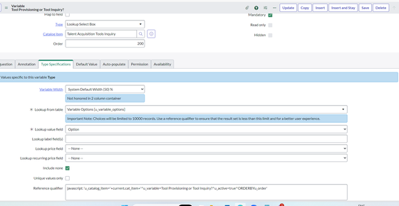

On a record producer I have tried to map a Lookup select box with category field on a Hr Service Case form using record producer script.
I have used below script but instead of mapping with the choice already defined, it is creating the new choice in category field. Please help me on this?
Record producer (filed):- tool_provision  (value comes in "u_variable option" table)

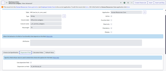

HR case form (field) :- u_hr_service_category  (it is a Custom Filed and Value Comes in sys_choice table)

@Community Alums Can you share the type specification screenshot of your look up select box.

@Community Alums HR Service Category is a dependent field. Could this be the reason why a new choice is getting created?
