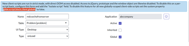

To resolve above message:
Checked the "Isolation property" flag of CS.

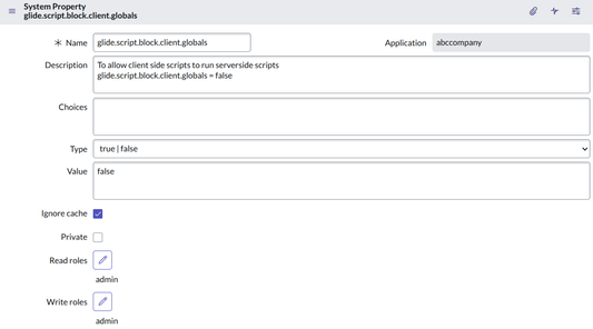

I created the app. property "glide.script.block.client.globals" and set it to false.

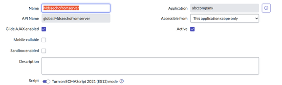

3. Created SI:
var Mdssechofromserver = Class.create();
Mdssechofromserver.prototype = Object.extendsObject(global.AbstractAjaxProcessor, {
    echoParameter: function() {
        var problemNumber = this.getParameter('sysparm_num');
        return problemNumber;
    type: 'Mdssechofromserver'

Also, I would like to hear what role you selected while creating a new script include?
