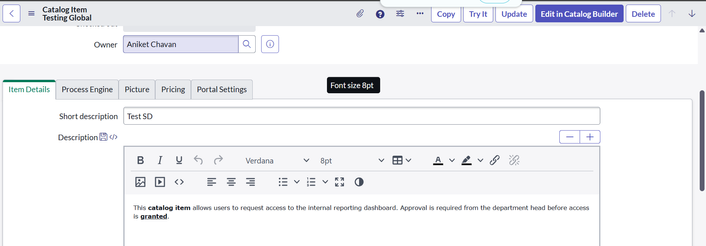

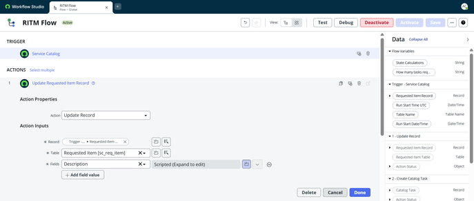

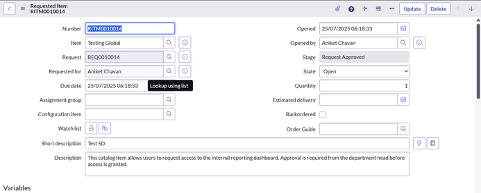

AniketC85155510
Hello @venkyk1309 ,
Yeah , you can use script insted of dot walk to set the description same as Cat Item by removing the HTML tags, just use the code below for besides desc ....
var catItem = fd_data.trigger.request_item.cat_item;
var desc = catItem.description;
// Strip HTML tags from the description
if (desc) {
    var strippedDesc = desc.replace(/<[^>]*>/g, '').trim();
    return strippedDesc;
return '';
Final Output:
this will work just fine, I just tested the same and also let me know if you are able to  see the Screenshots or not if you face any issues, seems like there is been the issue with screenshots ....
