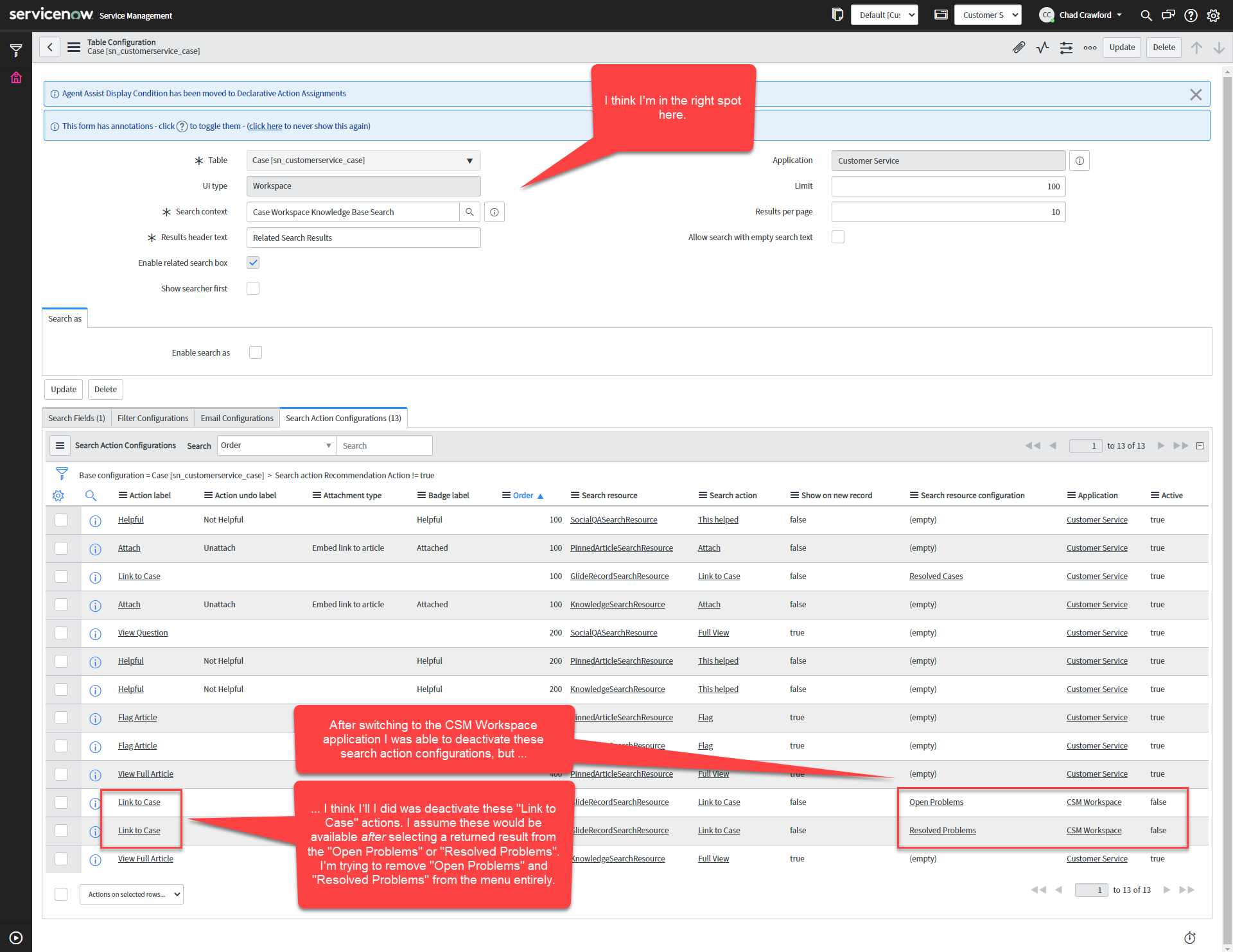

Thank you so much for your response. I followed the steps you described to best of my ability ...
... but I'm afraid I get the same results. "Resolved Problems" and "Open Problems" still listed.
It felt like I was in the right spot, "Contextual Search > Additional Resources". If I don't want to show "Resolved Problems" as a search resource anywhere (because we're not using Problem), I would be think that would be the place to deactivate it.
I appreciate your response regardless. It gave me a couple other places to look. I'll keep looking and report back here if I end up finding a solution.

For anyone looking to have the same done, I could disable them via the list view.
