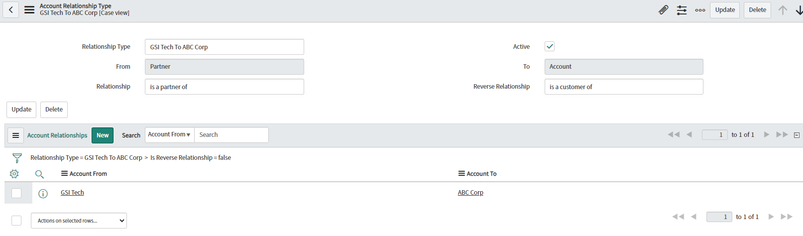

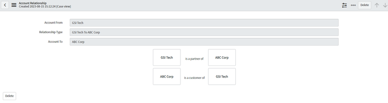

This is what I've done:
1. Creation of the Account Relationship From GSI Tech To ABC Corp and ABC Corp USA:
This is the record of GSI Tech To ABC Corp (It's the same as GSI Tech To ABC Corp USA)

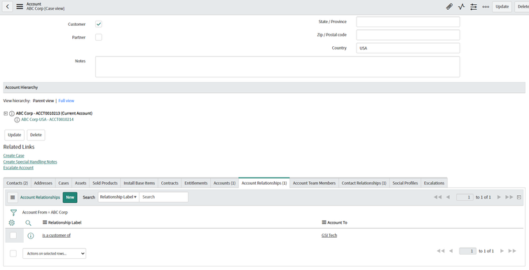

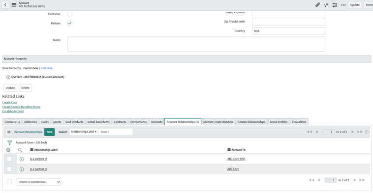

2. Validation of the account relationship for GSI Tech, ABC Corp and ABC Corp USA
GSI Tech
ABC Corp
ABC Corp USA

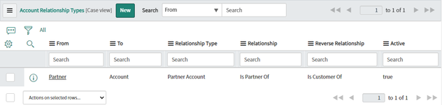

I have no Relationship Types in my simulator instance. My "Account Relationship Types" list is empty. I have created a new entry but my validation is failing.
Validation failed:
Example of my account relationship configuration.

@Lance Maurer . As earlier mentioned by Yu.
Partner is already a defined relationship. So long as you have created the parent account ABC Corp, its child account ABC Corp USA and the Partner GSI Tech records. You can go
Customer Service > Customer > Partner Open the GSI Tech record. In the Related List click the Account Relationship Tab and click New. As show in the below image and make your selection.
If you use the Customer Service > Customer > Account - the relationship Type is empty under Parent or Child Account.
On the contrary if something is wrong with your lab instance you can repair same via
Lab Management > Repair System Properties
Lab Management > Repair Machine Learning Settings
