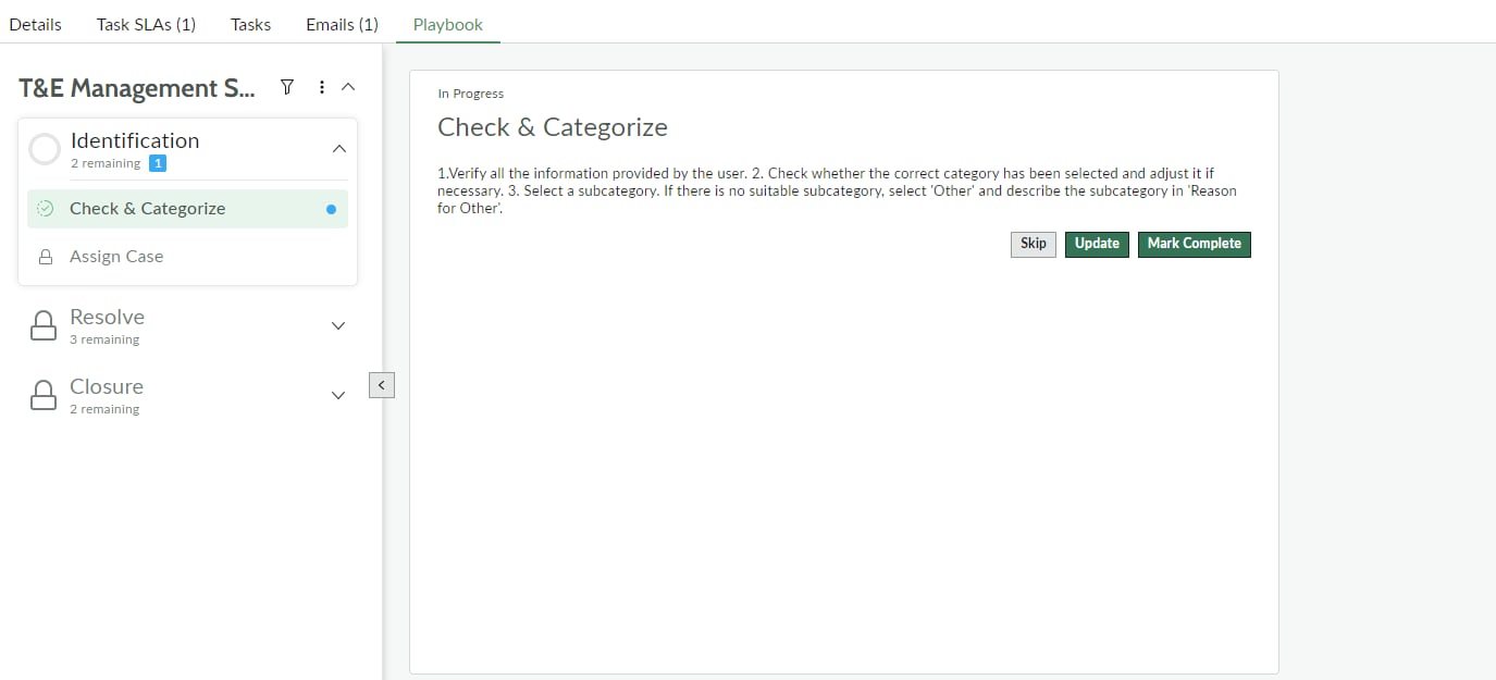

I am facing an issue with Playbook in CSM/FSM Workspace. I have made configurations for playbook.
Requirement: To show some fields in the case form in the playbook cards as per client requirement.
Issue: The playbook cards show the fields when I create a case from the workspace but when I create a case from portal in the same record producer, it does not show any fields (Attaching the screenshots).
I checked the form view to see if that is causing the issue but it isn't.
I don't understand how ServiceNow can differentiate a case if it's created from portal or workspace and make the fields visible based on that.
Appreciate any suggestions and ideas to remediate this problem.
Thanks in advance,
Ashwin

I found the solution to the issue. It's because of the view we add in the playbook card. The Record producer variables on the form is the reason why I was not able to properly see playbook fields.
So as a solution what I did is that, create a new view "playbook" and add the necessary fields to this view. Then change the form view in the playbook card to "playbook" and activate the playbook.

I had the same issue of it not working when submitted through a service portal. After investigation of the process execution, I found out that the Form View variable from the Activity Execution (sys_pd_activity_context) contained a string value of the title of the view (for example My View instead of my_view).
This is picked up directly from the configuration in the process automation designer that only allows to select a reference to a view. So for now my only workaround is to change the title of my view to the same value as the view name.

This was my problem, created a view without any spaces so title and name on the view was the same. just like @LaurentChicoine now it works.
