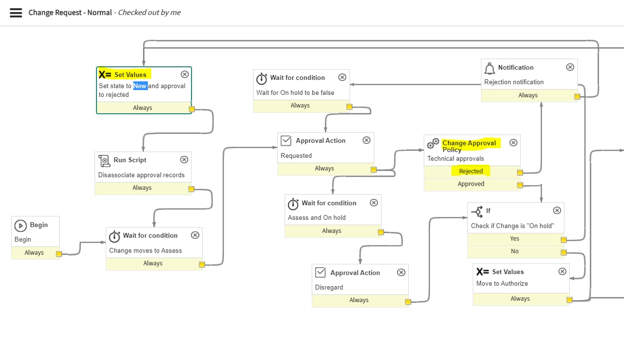

Can you post a picture of the current change workflow?

Hi Siddharth,
You need to check what is defined in the set Value activity on the workflow.
For reference please find the workflow for normal change below, you can see that the rejected branch apparently redirects to the set value activity where the state needs to be set as New.
kindly mark my answer as Correct and Helpful based on the Impact.
Alok
