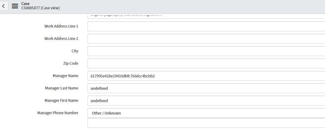

I am trying to write a client script on change of "contact" record, I want to auto populate the fields like manager's name, email address etc. Manager field is a reference to sys_user table.
      return;
  var contact = g_form.getReference('contact', callBack);
function callBack(contact)
	g_form.setValue('u_employee_last_name', contact.last_name);
	g_form.setValue('u_employee_first_name', contact.first_name);
	g_form.setValue('u_work_email_address', contact.email);
	g_form.setValue('u_manager_name', contact.manager);
	g_form.setValue('u_manager_first_name', contact.manager.first_name);
	g_form.setValue('u_manager_last_name', contact.manager.last_name);
Here is what I have so far and the results are turned out to be "undefined"
Please help. Thank you

You are using getReference() which acts as dot-walk for user table. For Manager's First & Last name it is double dot-walk. So it will not work in client script as above.
Better to change the Manager field above to be Reference rather than string & remove the First & Last Name to be set from the script above.
Once done you can have another Client script that runs onChange() of manger field & since it would be a reference field you can follow the approach that you have followed above for populating First & Last name.

Manager field is a Reference field in the contact form but I am trying to get managers name, email in the case form so that I could use save them for each case record.

To clarify, the contact table (customer_contact) is an extended table from user (sys_user).
I have a case form (sn_customerservice_case) which is an extended table from TasK.
In sn_customerservice_case there is a field named "contact" which is a reference field to the customer_contact.
Manager is a custom field I created in sn_customerservice_case table to get the contact's manager name.
I am trying to get user/employee details and manager details in the Case form and store the data in the case record.
