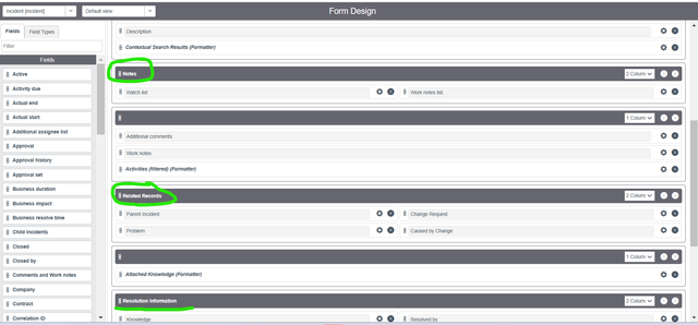

Rohit  Singh
hi @sreeshsurendran , Form sections can be configured using Form Design. You can add or remove a form section or you can also add or remove fields of any section.
In below snip see various section of an incident record highlighted in Green.
If my response helped, please mark it correct and close the thread so that it benefits future readers.
