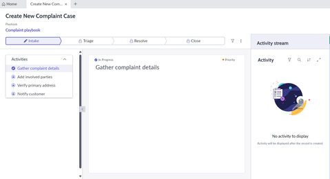

Hi all,
The requirement is to deactivate the Playbook available OOTB for Complaints and need to show the Complaints form as same as the Case form which is shown in CSM/FSM Workspace. The agent should be able to fill the fields available for Complaints.
  • The current behavior is as below:

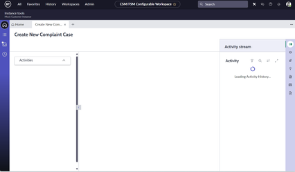

  • I have tried deactivating the Playbook from "sys_playbook_experience_record_generator" table and deactivating the Process Automation Designer available and below is behavior then.

@sreeshsurendran
I don't think it will work without playbook because it looks like the playbook lanes/activities are rendering the UI
