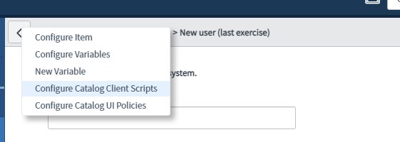

Hello, you can try creating a client-side script from your catalog item form. You can do this by the context menu as shown below.
Then you click the New button and set type field to onSubmit. To avoid item to be send if a certain condition is not meet, you can try something like
if(!condition){//note that i am checking for false result
g_form.addInfoMessage('A message to indicate the error');
return false;
You can also use g_form.addErrorMessage() to set a message more clear.
