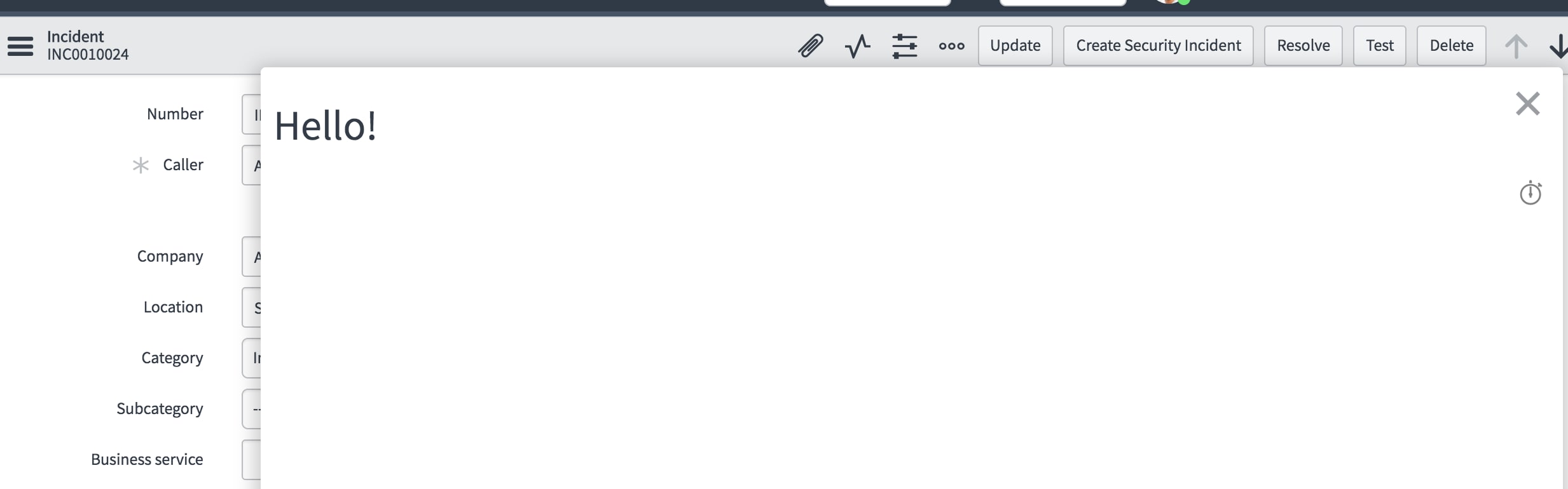

Try something like this, it worked for me...
<script>
<a id="test_id" onmousemove="g_popup_manager.enqueue(event, '', 'my_test_ui_page.do', '', 600)" onmouseout="g_popup_manager.destroypopDiv()" >hover here</a>
</j:jelly>
The result:
And again, being an unpublished API, I have no idea what the future may hold for it.

‎02-21-2017 04:00 AM
Hello Joe,
Thank you, this seems to be exactly what I need! I can display a custom UI Page in a popup with that code. Now the new issue is the popup is showing up in the right bottom corner of the page and it's way too big.
I've been looking at the GlidePopup javascript code. I can see a function 'queuePop' which should be the one that calls 'showForm' later, but apparently lets you set up a width, and the 'lastX' and 'lastY' variables might be the starting position? (not sure about it tho). However I can't seem to make it work calling 'queuePop'.
Were you able to make it work calling 'queuePop'? Either that or 'enqueue' or 'enqueue2' maybe.
Thanks!
