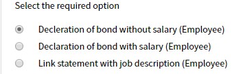

how could I pass a Value from multiple choice question on record producer to the back end form?
That is the question on the record producer:
current.u_boolean_3 = producer. <and then what?>
Any help would be appreciated.
