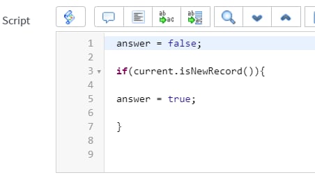

So looks like you have the first part working, to only view their own records.  For the second part you can use a write ACL and include in the script
answer = false;
if(current.isNewRecord()){
answer = true;
this will allow creating records, but block once the record is no longer new.  You could even expand it to allow certain write access to existing records based on other items if you like.
answer = false;
answer = true;

OK, so that first part did the job in making those records visible, but read-only.  However, now when I click on the "New" button (when impersonating one of those users), it shows the Submit and Save buttons but no fields!
This is what the Write ACL looks like:
And then I added a Create ACL that looks like this:
I even trying adding explicit field write ACLs, with the Role showed above, but no luck.  The person I am testing has that role, but it is not showing any fields at all to enter information into when the New button is clicked.
