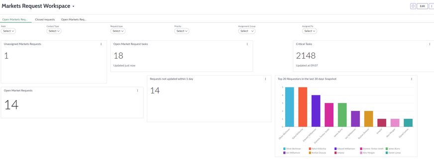

I've currently got the following Workspace setup:

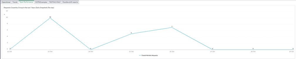

I've also got a separate dashboard which contains the following PA Widget:
However, I can't find a way of adding this PA widget into my Workspace. I was just wondering if somebody could confirm if this is possible to do and how I would do it.
10-30-2023 02:17 AM
Unfortunately No!! That's not possible as of now. Workspaces is built on a completely different technology and thus you cannot add a PA widgets.
Instead you have to build Next Experience components. See https://docs.servicenow.com/bundle/sandiego-application-development/page/build/components/concept/cu... for a starting point.
